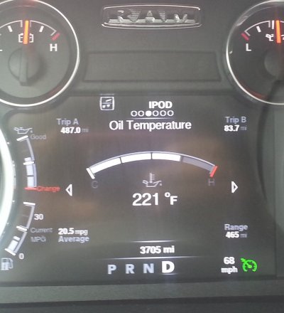

Here is mine with a light load in the bed but this is normal when empty as well.
Interesting thing is that during an 8 hour trip, tranny fluid is barely lukewarm, lol.
This was when I was traversing some hills with about 500lbs in the bed.
That is as high as I've ever seen it and I doubt if it would go much higher as long as the cooling system is operating properly. I think the gauge itself is misleading since it shows 3/4 of the way before you are maxed out but temperature wise, I think the indicator should be more at half to be acurate.
Oh and sorry for the crappy pics. The sun was on the driver's side that day and I hadn't had the windows tinted yet.:sorry:
