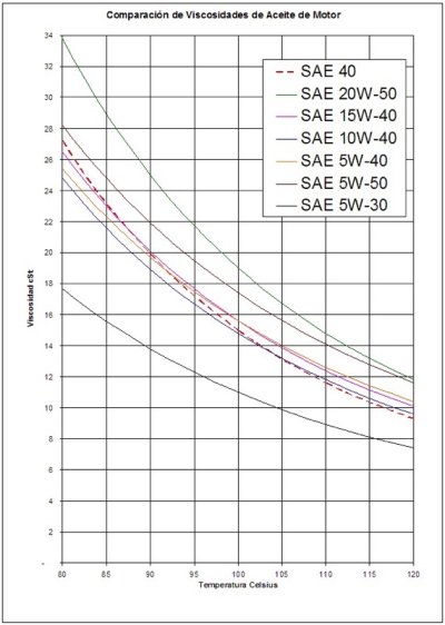

For oil 0w40 is basically the same thing as 5w30, the main difference is 0w40 tends to be thicker early in an oci, and 5w30 tends to be thicker later in the run. Now if you use 0w40 you would want top change the oil when it tends to be the hottest, same with 5w30 but less necessary, and a shorter interval is more desirable with 0w40 then 5w30. When I say 0w40 I mean shelf 0w40's, they are usually built on the thin side of 40 weight. And 5w30 are going thinner these days, look for one near cSt 12, or you can opt for 10w30 for just the summer, which may be the best option.

Another option is to get a 180 t stat. Oil viscosity is simply a measurement of flow at a certain temp. If you can run an engine cooler, it is like running a thicker oil by a full grade. Where this might get sticky is on long engine runs when the oil starts getting hotter then the coolant. If I lived in Phoenix, I'd do both thick oil and t stat upgrade. Look at the warm oil side, you can see by cooling the oil the cSt rises a grade up.

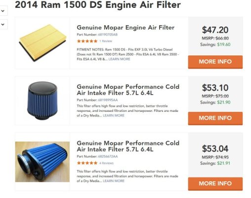

So glad i joined this forum. You guys are great and certainly know your "****"! are these the CIA intake OEM filters we were talking about in the beginningfilters.JPG of the thread?
