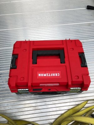

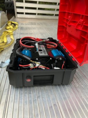

I had the ARB twin on my JL Rubicon. I repurposed it into a Craftsman tool box with some old jumper cables. It’s an amazing compressor.
