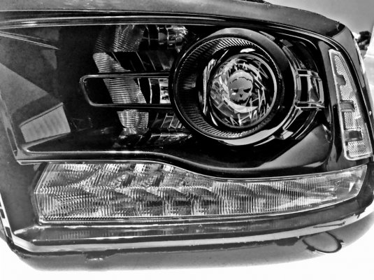

It’s not too bad, preheat the oven to 235 degrees then bake for 30 min and it’ll come right apart.
Then while warm I used a standard (straight) screwdriver to scrape glue from the housing. Then laid a new butyl rope in the groove and rebaked it for 30 min before inserting the lens. Reinserting the lens can be tricky but take your time. Then make sure you squeeze the two pieces together well. Start by inserting the outer point first then working toward the inside high beam edge.
