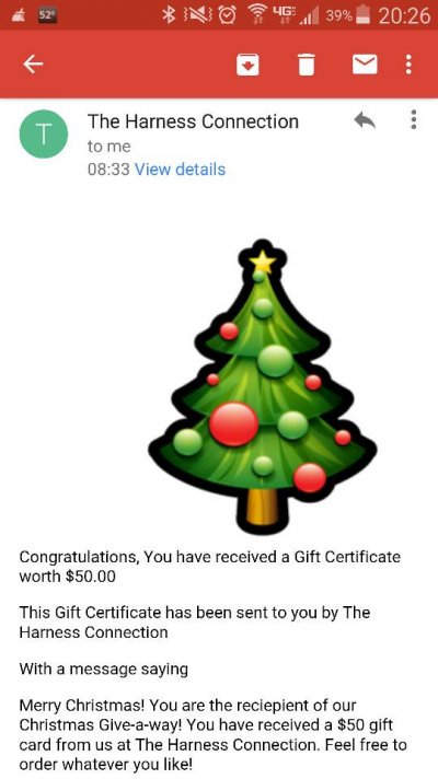

If your luck like I was you may win a gift certificate!
