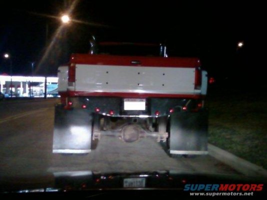

There are also probably just as many people that say they have no issues what so ever with the 4" blocks. I've found a few just today. Hell, I looked at one 4by website where a guy had stacked 3" and a 4" block together!!!! Now that **** is crazy!!!!! I think you'll be fine with the 4", just don't get crazy like this guy with what has to be 12" tall blocks.
