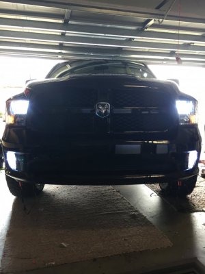

I'm going to say sorry again for those that I blind driving down the road. But this kit actually works and works well. I did direct the light to shine down instead of the factory position so this should help some with on coming traffic.

What kit's did you use?
I used the OPT7 Blitz kit at 1st before doing some major reading I hooked them up straight from the blast to the bulb and thought I was doing something go till I cranked the truck and they spazzed and cut off on me. So I order the OPT7 cap and relay kit. I installed the caps and thought I was doing something well again hooked everything up and cut the truck on yay they stayed on for about 20 min and then cut off. So I installed the relay and they work fine now, Its many youtube videos on installing the relay all of them are pretty straight forward. But the one I liked the best was the one that stopped the relay from buzzing like crazy. You have to use the capacitors to hush the relay.
