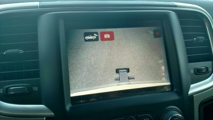

That must be new this year then. My 2016 badge camera for the front has a camera cable, with a power and ground wire spliced in. You might double check. I can't see how it would work without a power source/ground. This could be part of your problem. I also taped my connectors as they seemed less than tightPower was acquired through the supplied harness. Video and 12v was PnP for the cargo camera and the front emblem camera so there was really no tap in or ground wire to run. I checked my video input and wire routing. All was secure. I went as far as taping the video input plugs so the couldn't come loose.
I bought their new Enigma Premium with their front camera. It enabled the cargo camera and the controls screen which I did not even have the controls screen before. I have to click on cargo camera then I can toggle from their between cargo and reverse camera. With the front camera I have to double tap mute button or hold back button. I don't have the additional camera soft key for the front camera like their older kit. How do you change the picture of the startup screen? Also would you please post pictures of cargo camera pictures view and actually third brake light. I would buy the cargo camera from the dealer but cannot find anyone who makes the harness anymore.The harness that comes in the kit has two 12v plugs and two rca plugs. Simply install the harness between radio and stock harness, fish the camera wires through to the back of the radio stack and plug them in. No cutting no splicing no tap ins. Completely plug and play. Customtronix is out of Sweden and there is no US distributor. My gold + kit with forum discount was 485.84 USD shipped to door. That ncluded:
OEM grill ram emblem with their cam installed
OEM third brake light with their cargo cam
Nav input lockout fix
Front cam park view
Ability to add any photo to startup (splashscreen)
Complete plug and play wire harness
Software to install the above
Hardest part was fishing the cargo cam wire through headliner to back of radio. About an hour total install time.
