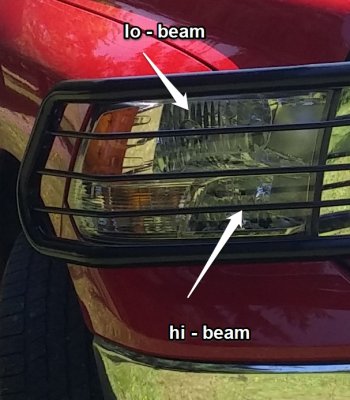

It's not stupid - really!
A "Quad" headlight is a headlight kit where the lo-beam is one bulb, and the hi-beam is another bulb. Same thing happens on the other side.
A "Projector" headlight has this big fisheye lens-looking thing in front of the lo/hi combo bulb.
Below is a pic of a Quad headlight (mine, to be specific)...
...and this is a projector headlight:
Partially true, but not totally - BOTH types of headlights have 4 bulbs (2 high and 2 low) However, the projector headlights have a "shield" which allows only part of the light from the bulb behind it to come out when the headlights are on "low".
Both types of headlights have 2 bulbs lite when in "low" and 4 bulbs on while in "high". The bulbs (for high and low) may be the same and might not be the same. My 2015 WITH projectors uses 9012 for low beams and 9005 for the highs. The ONLY real difference (there are many, but the most notable) is the shape and position of the tabs that twist-lock the bulb into place. Other differences are/can be the "heat" of the bulbs 4500K or 5500K or whatever, where the LEDS are placed in the bulb, how the wires attach to the back of the bulb, and others.
