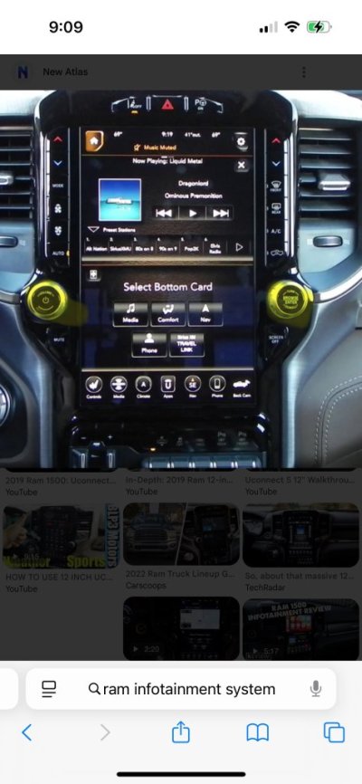

Do a manual reboot. Simultaneously press the volume and tuner buttons and hold for 20 seconds or until the system goes into reboot.

What tuner button? Back side of steering wheel? Will try this tomorrow. Thx for tip

Guess I’m making an assumption you have these (highlighted) analog dials.

I do, I guess I’ve never turned the one on the right!
