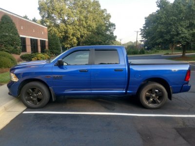

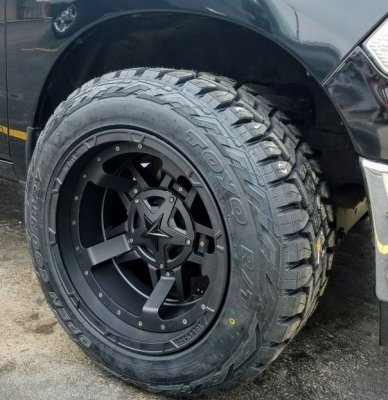

so i am going to be replacing all of my shocks in the next month or so and figured while i have it apart might be a fun project to paint my calipers. so a few questions...
1. whats the best method to go about painting the calipers so that they last?
2. what is the best paint to use?
3. what color should i go with? I have rockstar 3 rims on my blacked out truck and this will be the only splash of color i have so i want it to be bold but not ricer looking. I thought about possibly yellow, blue, orange, or green.
thoughts? Pictures of my truck attach for help

Man we must have totally different trends where I live because you literally named off just about every color that you'd see on a "ricer" only missing pink.
