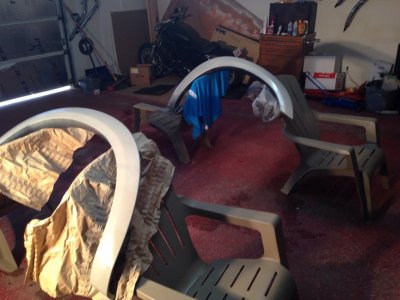

Started off with
My high tech saw horses. Oddly enough this hold my flares very well.

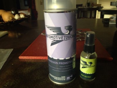

Step 1
Prep solvent and adhesion promoter

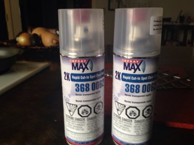

Finally
The clear

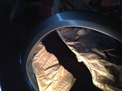

Everything
Should be a nice dull finish with no shinny spots. Shinny is always bad at this point. It means oil and oil will ruin your paint job.

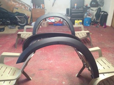

Start prepping
For paint. I always run 2 coats of adhesion promoter.

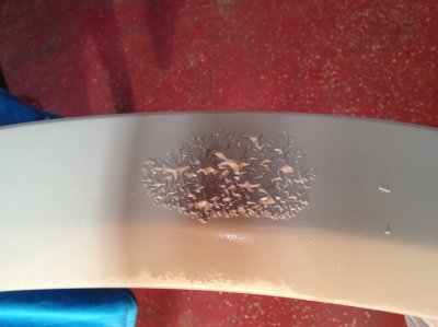

Orange peal
Sometimes, no mater the prep, you get this, and or fish eyes

6.7 Cummins Turbo & Hemi 5.7
My truck for a super smooth paint job
After the first coat of color I like to go back with so 1000 grit wet and level every thing out. It's really easy now to see the highs and lows in your paint. All your doing is knocking the the highs down to your lows.
See the contrast between the primer and paint. Now is the time when you want everything super smooth.
