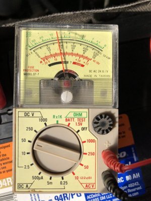

I have a new battery in my 2009 Dodge Ram Quad Cab truck but it is going dead after sitting for 2 days. I am a noobie with multimeters so I need some help interpreting the readings. I disconnected the black battery cable and am trying to figure out the current with everything "off". Here is the reading:
What I take the cable off of the fuse box I get this reading:
This is the cable I removed from the fuse box to get the reading.

First of all, you are on volts scale and that is not going to measure amp draw. Secondly, your meter even for amps is woefully inadequate. I would suggest finding a decent digital multimeter in the 10 amp range or even an amp clamp meter.

Thanks I had a feeling I was way off. The video helped a lot.

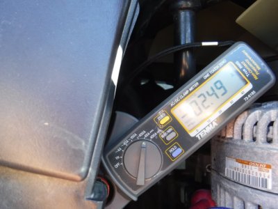

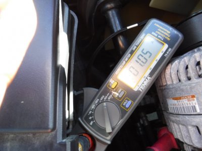

I'd done a little checking on battery amps load with the truck off a couple weeks ago before I added a 600W inverter under rear seat as it draws .02A while off.
Used a several years old AC/DC clamp on meter so can't verify its accuracy.
Measured at input to the fuse box, hood light disconnected.
Truck Off .06A to .07A
Truck ready to start after touching door handle: 14.06A
Truck ramps down to 2.5A within a minute if not started, then sits at .25A about 5 minutes, then back to .06A
Hood light draws about 1A when on.
Truck Off Amps .06A  DSCF3031.JPG Truck Ready to Start 14.06A  DSCF3022.JPG Truck Stepping Down Amps 2.49A  DSCF3018.JPG Truck Off w Hood Light On 1.06A DSCF3028.JPG
