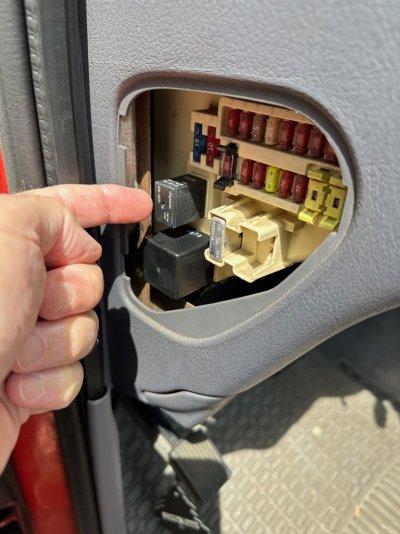

My 2nd gen dodge ram front passenger blinker quit? I checked the bulb and cleaned the contacts amd nothing. I checked the Fuses they were OK. i replaced the Blinker Relay and still nothing I and just changed the Blinker Switch to no avail. Also it doesn't work when the Hazard Switch is turned on. All three of the other Blinkers work just fine. All four light up when the Park lights are on.

Sounds potentially like a broken wire. Have you checked wires with a voltmeter? Take the housing off it and disconnect and see if you are getting power at the wire ends. If not, you will need to trace backwards to find where it is broken or disconnected.
