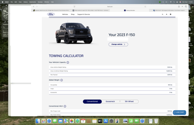

As some of you know I have a F150 as well as a Ram. The towing capacity on the F150 is easy to figure out. Ford has a towing calculator, you put your vin in, and it tells you what weights you can tow, minus the weight of the add ons on your truck. Here is my resultsScreenshot 2025-09-07 at 19.48.50.png

That is a really neat tool to figure out what the payload would be. Wonder how many truck owners actually use it?

It's cool that Ford offers that, but there are also other sites that give you the same calculator for those who are struggling with the numbers and who don't drive a Ford. Sometimes I wonder why folks don't just use those versus just winging it or arguing about it on a forum. :Big Laugh:
