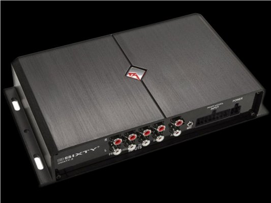

Gonna need a processor for that....so I have a Rockford Fosgate 3Sixty.3.
The laptop tuning ability looks really fun.
