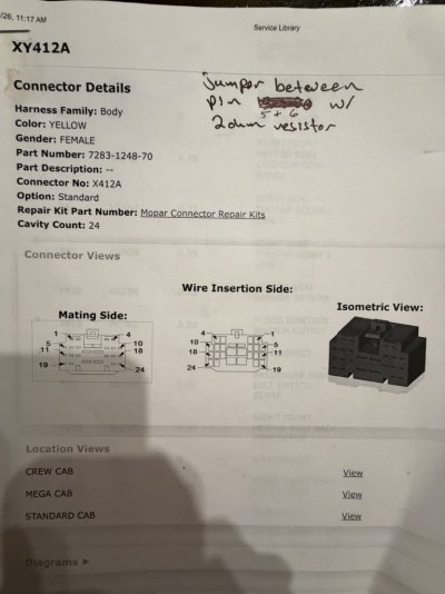

I just managed to get this figured out with the help of a service tech. Put a 2.2 ohm jumper between pin 5&6 on the yellow connector under the passenger seat. These are the right seat thorax squib 1 line 1 and line 2 connections. You can buy pre wired jumpers on Amazon if you opt to be lazy like me or buy the resistor and make your own. Be sure to disconnect the battery for 10-15 minutes beforehand. Or let the truck sleep for 10-15 minutes beforehand.
