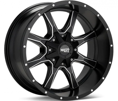

Just to get it done, since TireRack was able to do 1-day delivery on the wheels and sensors (damn that's fast), I have these coming to me tomorrow along with what TireRack says are OEM Mopar sensors for $40 which is cheaper than elsewhere (and could be ********, won't know till I get them):
Moto Metal MO970 Black w/Spot Milling in 20x9x18mm
Total came out to under $1K shipped, and 5% cashback right now if you use chase w/ paypal for another fifty'ish back. Plus, hopefully I can sell my stockers w/ tires and stock sensors for a decent price to someone that likes chrome.

Gonna look awesome. Good luck with them! Make sure you post pics once it’s all done.
Excited!
great looking wheels, same ones I had on my 2015, but were black lip, Anthracite center, and on my 2019 below, have those in all gloss black.
easy to clean! :)
