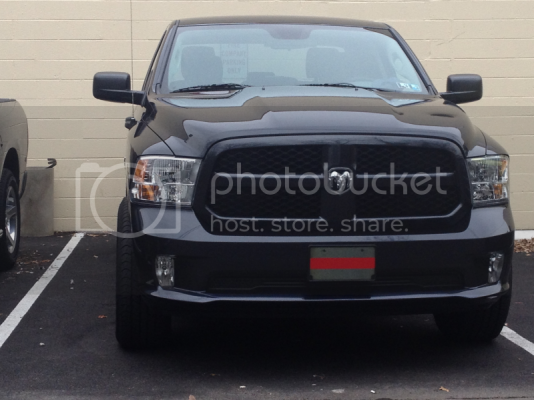

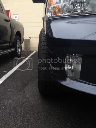

2013 RAM QC 4x4 Express ( NO LEVEL / LIFT )
20x9 - **** Cepek DC-2's
-13mm Offset / 4.49'' Back Spacing
Tires - 275/60/20 OEM CRAP YEARS
My due to my low offset rim, they stick out of the fender by about 1'' - 1.5''. I have an aggressive looking stance I think for a stock height truck. it's really noticeable looking head on, or directly from the rear. I personally would like to add wider tires ( 305/55/20's ). I am no where near close to rubbing with my current set up, and should I decide to lift, and throw some 35x12.50's on... I would still have NO issues at all with rubbing.

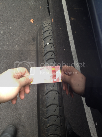

Pics from directly in front of the truck would be great. This would really be the best for showing how far they "stick out".

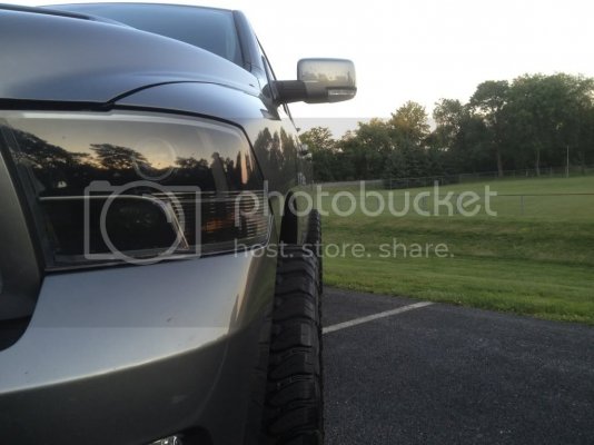

******* I lined up the edge of the gift card with the fender line of the truck to give you a comparison...

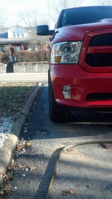

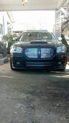

Oops that's the wife's Magnum .LOL

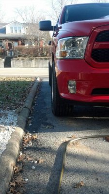

My truck still bone stock no level no lift , Factory 275/60/R20s

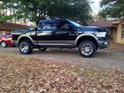

here is a pic of my truck before the fender flares. 20x10 wheels with -24 offset(4.5" backspacing) and 33x12.5x20 toyo open country m/t's

Thanks for moving the thread ! Do you have a level ? Or any rubbing issues ?

i do have a level, but i'm not sure it is necessary. i do not have any rubbing
