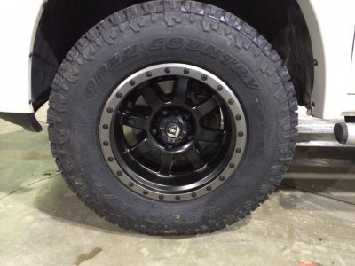

StevoTee
Sep 12, 2013
98
14
2011 Ram 1500 Crew
3.5" up front
1.5" rear
295/70R18 Toyo ATII Extremes
18x10, -12mm offset Fuel Trophy
No rubbing or any fitment issues. Most likely can't fit mud flaps on the front. Installed them on the rear.
Tires stick out about 1.5", but I have Bushwacker Extend-a-Fender, which cover 1.75"... roughly.

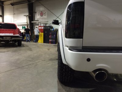

White Beauty
Jun 17, 2013
1,227
314
Moncton, NB
2011 Ram 1500 SLT
17x9 +20mm offset. With 1 inch wheel spacers (thus creating a -5.4mm offset)
35x12.5 toyo MT's. Pic is when I just had the 2.5level.now has 3inch BL and a 1.25 spacer.
I had no rubbing or fitment issues with the wheel spacers installed.
Sent from my SGH-I747M using Tapatalk
