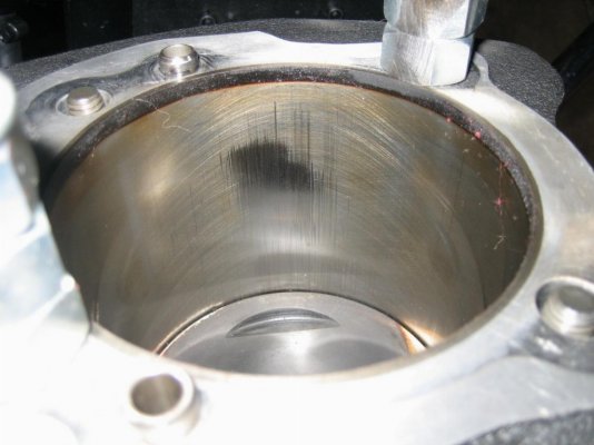

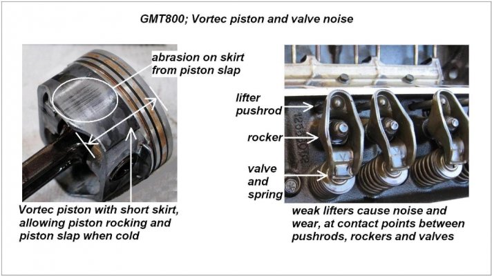

If you search the pics of piston slap online, you just see scuffs on the side of the cylinder, but because this happens at the bottom of the piston it is not hurting anything. The combustion chamber that supplies all of the power is not affected by this. And since this literally goes away as the metal warms, you guys see it is harmless. In the photo's I see online it is never more then a scuffing of the surface.
If you are worried, you can always do a uoa and look at fuel dilution, as long as your rings are sealing good, I don't think any damage that would be fatal is happening.
