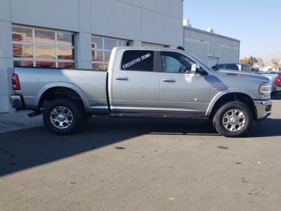

Going to inquire about this 2019 Larime 2500 with 11.5k miles at a dealer for $58k. A little above my budget but it's a 2019 with very low miles.. I know there's a lot of description to read thru but all I'm looking for is opinions and maybe what to watch for. I'll be towing 8k lb to 12k lb travel trailer. I retire next year so this will likely be the last truck I buy.
**CLEAN CARFAX ONE OWNER**, SUPER LOW MILES, FOUR WHEEL 2019 Ram 2500 Laramie in billet silver metallic clearcoat.Certified. Certification Program Details: 118 point vehicle inspection 3 month / 3,000 miles comprehensive limited warranty with a $0 deductible Complementary vehicle history report GarffCARE roadside assistance Powertrain extending additives: Engine deposit cleaning additive Transmission conditioning additive Fuel system cleaner Cooling-system treatment Artic Blast A/C treatment Power steering fluid conditioner Second key and remote Free home delivery available No hassle return/exchange for 5-days or 500 miles Odometer is 14192 miles below market average!In addition to transparent, no hassle pricing and upfront no hassle trade evaluation.....We provide an enjoyably brief and easy Sales Experience...Your Pace...Your Deal...No Exceptions!

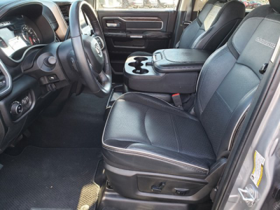

Looks nice, probably a decent price in this market. What does it have for interior options?

Black leather interior.

Just FYI, that is a generic "description" of a basic 2500 and not the exact one for that truck so be careful. A 2500 Laramie does Not have a #3200lb max payload capacity. That would be for a completely stripped down single cab 2wd truck.
