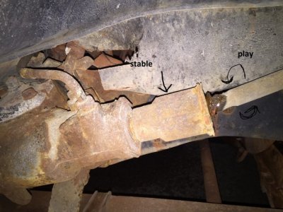

are you sure all the slop is in the box and not in the tie rods? there is an adjustment on the top of the steering box. just make sure you don't adjust it too much. it is not a brand new vehicle

not a real good pic but hopfuly you see what im talking about

sorry for the lettering here it is again

you need a coupler rebuild kit or Steering Shaft Repair Kit. they usually go by those names.
