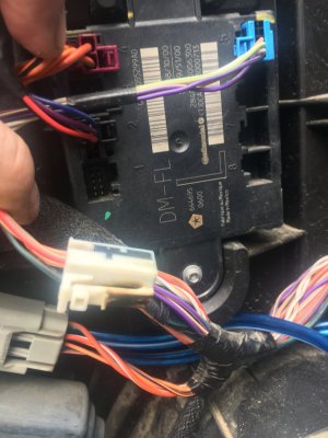

I have 120,000 miles on my 2010 ram 1500. Tranny and motor run fine. I do have to replace my leaking rear outer axle seals. Also my drivers door module melted, and i replaced it yesterday. Seems there was zero dialectric grease on the plug. I reccomend pulling the door panels, (which takes 5 minutes) pulling back the film, and applying a liberal amount of dialetrical grease to the module plugs just to be safe. Replacing my melted door harness was not fun.

Thanks for the advice about the dialetic grease. It's advise like this that can help other forum members before the issue arises.
I'll check mine as it's a simple procedure for sake of preventative maintenance.
Edit . With door modules I thought you were referring to the windownswitch control etc?

Dealer told me its called a door module, but who knows. Haha. This is it.
