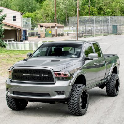

Hey everyone! I really hope someone can help before I go buy a Ford! Haha (Kind of not kidding though)
I have a 2012 Ram 1500 Sport. Only 45k miles. I had a 4” RCX suspension lift and I added a 1.25” body lift and then I added adjustable Bilstein shocks up front set at 1.8” I believe and a small rear spacer to level it out. I also added JBA upper front control arms.
I also run 20x14 Anthem Gunners and 35x12.50 AMP Terrain Attacks.
I’ve had the wheels balanced 4 times and have done 2 alignments. The alignment is still not right though (some mechanics don’t know their a** from a hole in the ground!) ..... But I am getting a very bad shake!! Feels like driveline shake to me?
Can anyone tell me what to check or where to begin?? I thought if I bought the driveshaft drop for a RCX 6” it would help, but Rough Junktry said the drop brackets are the same on 4” and 6” ... So I’m lost.
