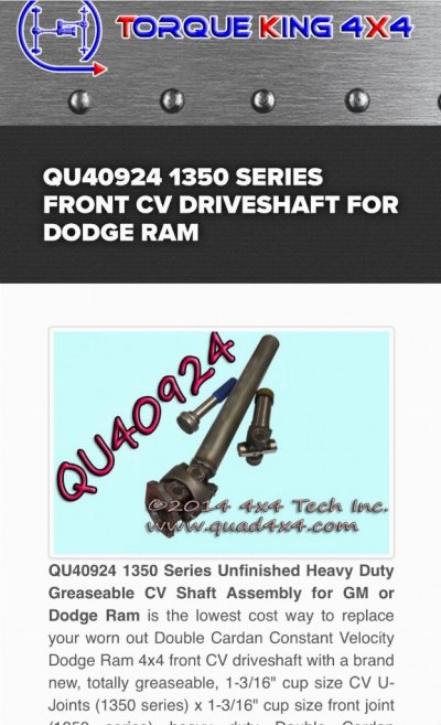

So I guess I’ll replace that. Are there better CV axles I should buy?? I prefer to upgrade a part if I have to replace it anyway.
Really appreciate all the help!!

If you replace one cv shaft do them both at the same time (if the wallet will allow).
As far as a better shaft I’d do a search.

I love the truck. Have no other issue other than this shaking.
I did check the driveshaft for a lost weight and it seems fine. I shook everything down again last night and I did notice some excessive play in the drivers side CV axle. Which could definitely cause a shake.
I don’t know how to do a link other than open them. But this is a badass cv shaft
