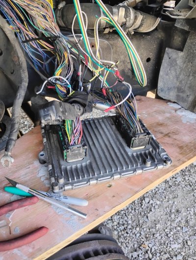

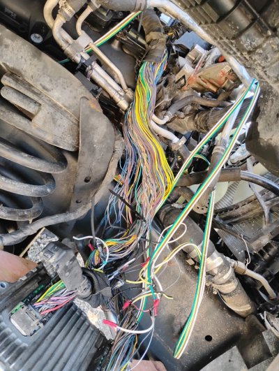

Please help ..I had my skid plate off because a clip was missing and it was flapping in breeze...well a monster breaker Rock fell off of dump truck in front of me. It sounds just right through it went up in the engine compartment snacks a clutch fan clutch fan disintegrated chopped my radiator hoses radiator and half my electrical harness at the computer. I slowly put each wire back together soldering individually trying not to move things so I didn't get lost or seperate the wires from mates but I got 3 wires idk what to do with. And now when I hook up batter( charged) I get the start up message saying " push in clutch" ...it's automatic....and my radio locked up. I got to get to work and I got to get out of the parking lot before they throw me off and somebody please help me with the pinout sheet for the computer when you're looking at the engine bay it's all the way up front on the right and it's the front connector.

Simple. You need a new engine harness. No shop is going to attempt to repair that with any kind of warranty to back the repair.

It can be fixed, but not in a stupid
Parking lot , without a wiring diagram
And meter.
Also need water proof connections
With heat shrink .

The harness is not that bad to get out and replace. The majority of it is on top and easy to get to. Especially on a truck.

Yeah I should give you guys a little background on me my daughter is actually named me fix it Felix I ran my own concrete company for 7 years maintain every fleet vehicle that was 14 pickups ukraines bobcats All That jazz and my baby is Dr plum full of everything I can eat mom I knew industrial concrete floors pouring and finishing so I'm all over the country and last year alone was Texas Minnesota to New Orleans Philadelphia New York Iowa to fix everything on the fly because it happens to me constantly it breaks down and f****** I just all I have is me all the equipment to do it mostly I had I have a meter I have the multiple soldering irons plugins and torches and solder and heat shrink the one thing I am still missing and even the dealers having problems with it is the wiring diagram to pin out simply just the pinout coming off of the ECU if I can get that pin out it's golden I had it all the way back to where it was just a throttle body that needed to be trained some of the wires got mixed up between the throttle body and the crank sensor camshaft sensor so I can't I want to just go in right at the the connector for these view and pull it right off of them you know off the pins I don't want to go in between anything and get the throttle body I think it has three quarters were done the crankshaft position sensor I don't know which one it is because there's multiple wires that are exact same color or tiny variation and with it being a 2018 and my running wires are dirty no other option would be to run up to eau Claire Wisconsin to have a new harness while salvage harness and just piece it cuz I mean there are connectors that go down into the engine or connectors at the back of it in front of it just take the part that I need but I need my my truck back really bad really really bad. If anyone at all can help me please with the pinout off coming off the ECU for the connector what the wires are the colors I can get close with the colors but if I know exactly which pin it was there'd be no question otherwise I'm going to start hooking up a tracer wire tracer from point A to point b I think started the sensor and then go back for VCU I don't know I get lost in it that's for the problem that there's so many wires so many connections you just get lost. Thank you all for the Post in the advice I wish more of a baby truck than it is but she's got 230 on her new training couple years ago and the pandemic came down from Canada somehow border closed and then I put a new one and last fall. I only did the full engine swap because one is the exact exactly what I needed became available from a close friend and I was chasing chasing things down in it like the lifters went and then it was you know once that goes you're chasing hell now I just need the wiring fixed and my baby is rolling

Go to the Mopar connector site:
Scroll down to Select Year and Select Platform
Select Find now and then scroll down to Module-Powertrain Control C1 anC2
One wire at a time and you'll do it. I strip about 3/16 of insulation from each end, put a length of adhesive lined heat shrink on one wire as far from the splice as possible, push the strands together, wrap a single strand around the pushed together ends like a coil, then solder, slide the heat shrink over the splice and heat with a heat gun until you see the adhesive ooze, and you are done with that wire. Same for the next, etc. Here is a link from Chrysler:

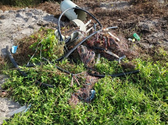

Shoot,those wires aint nothin....check out this mess.
2 blocks over from my house one of the big spider-monkey big ditch mowin tractors(as i call them)decided to make the little green phone poles their b*%$h.
Well,this took out my internet for almost 3 weeks now...people are takin their sweet time puttin it back together.....tech guy that came out and said there's 600 phones lines in there....8 wires to a line...dam!
Maybe there's a phone guy here that can verify this...theres 8 lines in the box on my house..not all are used though.that pic was like 3 days after the Incident after they already messed with it...way worse the 1st day when I stopped.

Man, that phone pedestal is all kinds of messed up. Wonder what damage it did to the mower. My brother-in-law worked for the county on a mower. He had stories about the stuff that was hit with those mowers.
