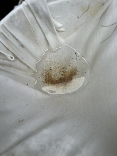

plugged heater core
samsdad02
Apr 16, 2024
71
34
mass
first pic is using the air/water gun to blast crud out. second is what the circulator pump pushed out. I reversed direction with both methods a few times. I lost some of the crud in the first pic blasting.

I flushed my radiator/entire system about 20 times before I stopped getting sand/crap out. Took a week. I would drive it 30 mins every 3rd flush. Used cleaning agent 3 times. Then went and did heater core again. Everything good now.

Sometimes you can flush it till the core leaks and it still wont unclog it. Mine did. Replaced core and 1.5 years later I have to flush it every few months to keep heater working half as__. Awhile back I ran approx 75 gal thru core. Needed to do it again in just a few months

Where is all the material coming from that's plugging it up?

I have to wonder ................
Is the sand coming from the Radiator or the Heater Core
Has anyone cut the Heater Core into quarters, after they bought a new one.
Is the core a simple Cross Flow or what

Truck at 111k when purchased.Looked to be clean coolant. That fall had weak heating. Flushed,and again next spring then in summer. Core started leaking and replaced it.Mechanic flushed before installing new core.I made it thru one winter good heat. Flushed it again,lasted few months and low heat again. Never seemed to get any contaminates from the system that we could see. On a warm day maybe soon I'll flush again and see if I can make it rest of winter with good heat. Needless to say I'll never buy another vehicle from this carmaker.(It will always heat good on passenger side).

I've been told the cores lay at a approx 40° angle and contaminates settle in one half of core. I reversed hoses to try to back flush several times.Drove it maybe 500+ Doesn't seem to make any difference.I've flushed core separate from engine,then flushed engine numerous times with either no results or results that doesn't last long,even with new core. I'll not ever replace core again even if I have to go without heat at all.It always does heat on passenger side. But I'll use another truck for good heat on very cold days instead. Sad,sad quality from Ram
