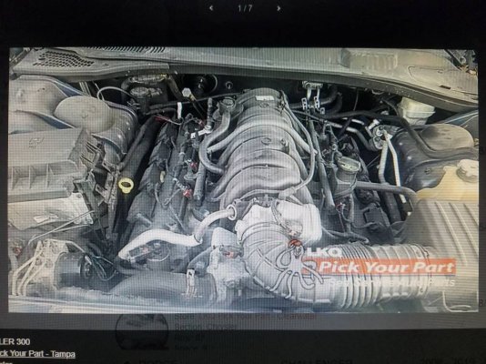

Just got this ping from my local LQK of a seemingly 6.1 hemi equipped vehicle, can someone please confirm whether its a true 6.1 or just an intake on a 5.7, please? a0bec5f67023dc24fe1eeac40f807ee0.jpg

That’s a 5.7 car intake and engine. You can tell by what looks like a flat smashed part on the front of the intake. The 6.1 is completely smooth and rounded

That sucks. I looked up pics of the 6.1 in a 300c and everything looks the exact same as above, except the color of the intake, that smashed part (which I thought was just some damage), and the 6.1 had some plastic covers over the coil packs.

Yep, 5.7. The 6.1 intake is metal. Also the 6.1 does not have EGR (left front, cylinder head to intake manifold). Not even an eagle 5.7, 06-08 LX.
One you found looks like mine lol

Yeah, I looked up pics of a 5.7 model and it's an exact match.
The listing is for an 06 300c.
****. False alarm. I'll sure as **** be able to tell next time, though! :D
