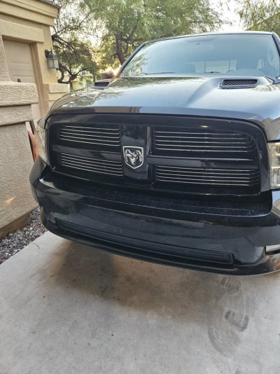

What grill do you have,the sport grills are more airflow restricted then the wide open honeycomb grills are. Post a pic of your grill.

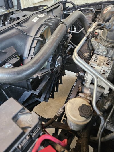

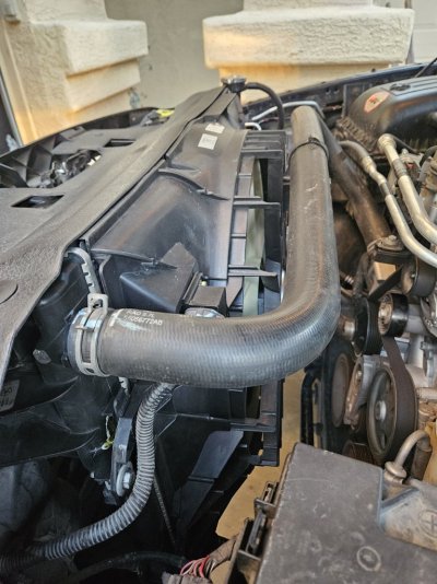

Here are some pics of the grill and efan.
See if you can hunt up the honey comb inserts for your grill. They might be the differance you need.If you look at your grill real close,you'll see it's a fair restriction to airflow
You want this style grill insert if you can find it,the poverty trucks have them,lol.

I run the stock efan without the mechanical fan and don't have any overheating issues - stock stat.
Your grille is air restricted and can cause the engine to run hot, I ran into that when I used that grille. Towing at 70 mph on a 95 degree decent humidity day, the temp would run at about 210 -215 w/ac on. Same conditions but at idle in traffic, my temp rose to the low 220's, I had to shut the AC off for it to cool down that time.
IF the temp dropped below 92 deg. or so the issue went away, the amount of air the grille allows through is that borderline.
Honey comb flows a LOT more air as Wildone said - I have a honeycomb grille but am keeping it just in case something would happen to my 2018 Sport grille.
I also have a set of the inserts like you have that have been modified for more air flow and that helped - ie. cut some of the restriction away.
