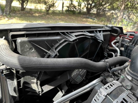

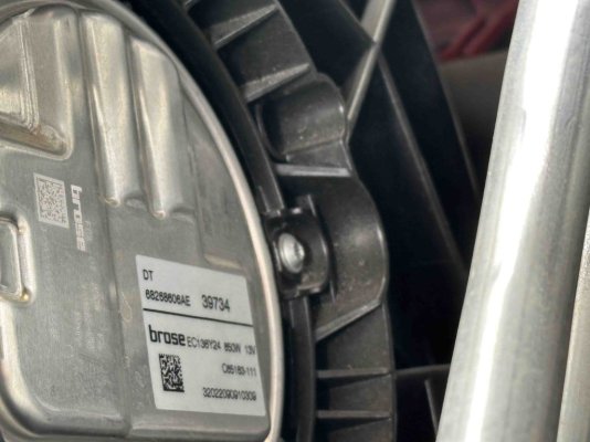

DO not know if pics help, but here is fan and part number. FTR, Mine is 2019 5.7L DT truck.
