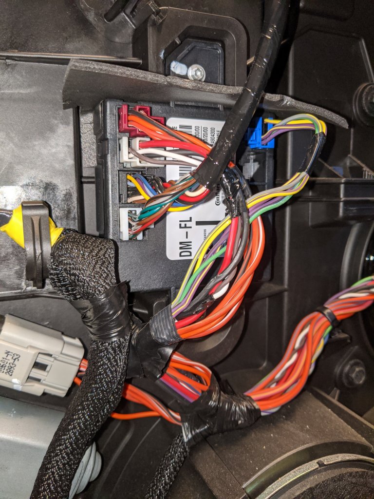

Sorry as I am brand new to this forum but really need some help. I have a 2014 ram express. I just upgraded my stock mirrors to power fold/tilt/heat/turn signal/puddle light. I installed the mirrors with no problem and the tilt function worked. I then used alphaobd to turn on the turn signal and puddle light. The only thing I can't get to work is the power fold. I upgraded my window switch cluster to have the power fold button and turned on the power fold option in alphaobd and still nothing. The only thing I didn't do was change the door modules as I didn't think I needed to since every other option on the mirror works. The donar mirrors were from a 2014 Laramie.
I have attached pictures of my stock module of driver side. Thanks!

You need the door modules from what it sounds like...

There is a thread on this by @Mpgrimm2 on the forum with all the parts needed. Let see if I can find it...
