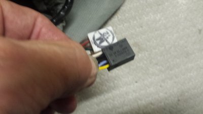

If it's a power folding mirror it should have two separate plugs. A white plug and a black plug and alot more wires than your describing. All of the factory power folding mirrors I have seen have the two power fold wires in the Black plug and they are light blue and yellow. If you have one plug with the color wires you mentioned I would guess it's a power adjustable mirror but not a power folding mirror.

The set I picked up was a used one from 1A auto. An older part number but it does have both connectors as well. The drivers side has 2 with the black one containing the yellow and blue wires but the passenger side does not. There is a small QD connector with a green and yellow wire on that side that connects to the black plug, I'm gonna assume that's the correct wiring for the mirrors. Going to run a few meter checks first to confirm
