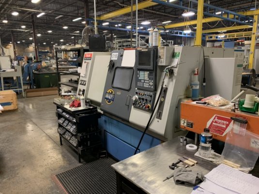

Side note.... as being a machinist by trade, and running lathes on the daily.... has my brain thinking, would an aluminum pulley be a good replacement, since I’ll likely have the old parts I’m half tempted to measure the new one up, and duplicate it out of aluminum on my lathe and go get some high quality bearings and press them in and rebuild the bad one for a back up/improved unit, or if aluminum is bad. I’ve got access to other materials (Delrin, stainless, etc)

I wouldn't recommend aluminum unless you're going to have it anodized. There is a possibility, however unlikely, that it will wear quicker. I do always upgrade any plastic pulleys to stamped steel if possible (grooved ones are almost never metal).
