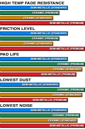

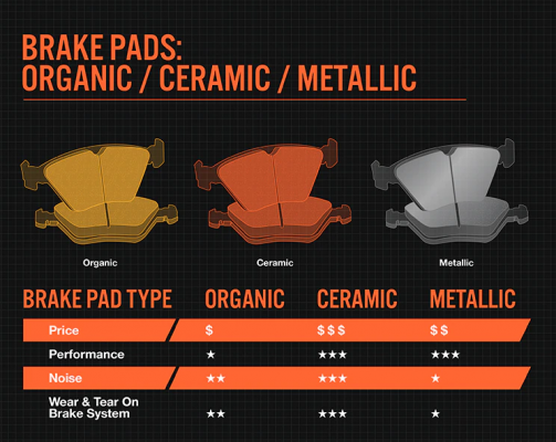

I'm not a fan of drilled rotors on the street unless its a performance vehicle and requires the additional cooling. I just did Wagner premium E coated rotors and performance friction carbon metallic pads and its a noticeable improvement over stock. I'm also not a fan of ceramic pads as I feel there performance isn't up to par and every pair I've had makes noise. Carbon Metallic pads have better bite, no heat fade and can withstand higher temps than ceramic.
