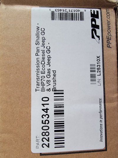

Hey All,
Is this the correct PPE pan (part #228053410) for a 2017 Ram 1500?
How many quarts of transmission fluid should I buy for the install?
Thanks

It's alot easier if you put a link up to it,as some of us are to lazy to look it up.PS: the forum also gets credits for links to products ,so don't be shy about putting up a link to whatever you want us to check out.
If the pans for a ZF 8HP70 it'll fit.
Spring for about 7 quarts of fluid,you might have a bit left over,but it's better to have to much fluid then not enough fluid

OP: correct pan (black, brushed aluminum, stock capacity).
