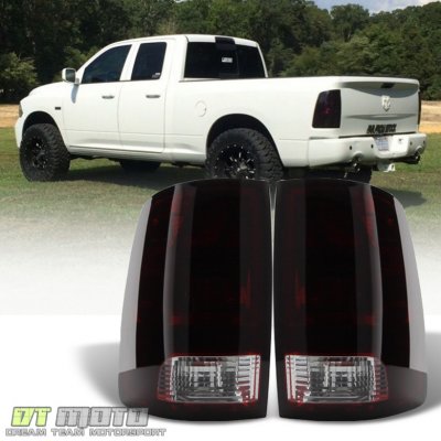

6B04F1DE-0FA3-4831-AAB6-06D4BA0030DC.jpeg Ok got another try and guess the lift size lol! Saw this while searching photos of blacked out taillights. Can y’all tell if this is a 4” or maybe just a level on 35s with 20x10 Fuel somethings?

View attachment 152749 Ok got another try and guess the lift size lol! Saw this while searching photos of blacked out taillights. Can y’all tell if this is a 4” or maybe just a level on 35s with 20x10 Fuel somethings?
Looks like a 3" body lift judging by how much the exhaust tips are hanging down
Great observation! I should’ve looked closer! That truck almost looks like it has a perfect stance!
