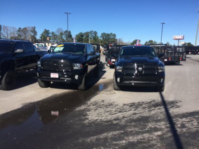

B2EF5AD0-CC2E-48B0-8BB7-794C6FC4C080.jpeg 9A658F65-73F7-4A67-B944-49A18111717E.jpeg 9A658F65-73F7-4A67-B944-49A18111717E.jpeg So I just looked at this ram with a pro comp lift and 35s/20s. Can y’all tell from the photo if this is a 4 or 6 inch kit? The tires did have a decent amount of space so I’m guessing it was the pro comp 6 inch.

Hard to tell with those pics.
Any side shots?
Did it have any rake?
Was the truck next to it leveled?
Possibly any shots of the blocks in the rear?
In the front, from center of wheel to the fender is a little over 29" and the gap from top of tire to fender is roughly 12"s on my 6" Procomp lift. If it is in the 27.5 - 29 inch range from center wheel to fender, it's a 6" lift.
Also, if it has the ss prorunner shocks, they can be adjusted from 4" to 6".

Yeah that’s my Ram next to it on right, Ive got bilsteins at 2.1 with 295/60r20 Toyo Mts. The tires on the other truck were Arturo MT or something like that. I did see the pro comp front lift but I didn’t look too close at the rest. So the pro runner shocks that are adjustable are those on the 6 in kit?

I believe the prorunner can be used with either kit. I believe that some of the kits come with or without them. Take a tape measure with you if you go back.
I think my mirrors just about clear a stock trucks mirrors with rake. Using my phone right now so hard to tell, but looking at the side by side and considering you are leveled, I'm thinking that is a 6" lift.

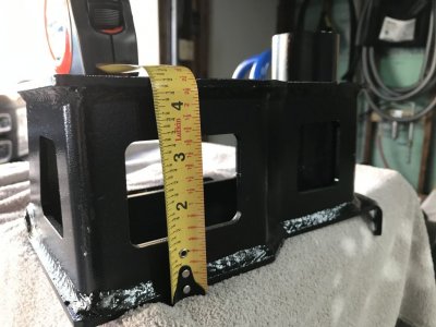

Could you please do me a favor?
Could you measure your rear coil spring spacer bracket height and let me know the dimension?.....a pic of the driver side bracket too?
For reference here’s the bracket for the 6” kit I have in my garage

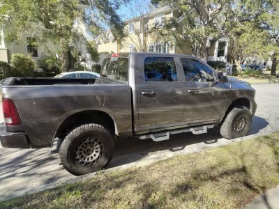

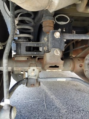

Bracket height is just a hair shy of 3.5". Pic of the driver side bracket is attached. Side angle of truck is attached for height reference too.

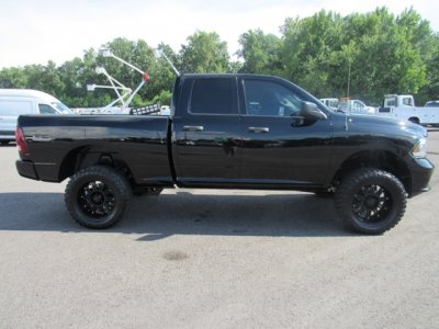

6” lift for sure. I have a pro comp lift on 35s and mine looks very similar. Could be just me but I always thought the pro comp lift sat a little higher then other 6” lift manufacturers and I always thought and still think my 35s look small on my truck

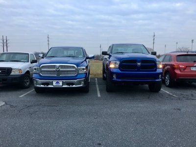

Thanks for the side by side photo Krein! Does look correct on the 6 inch as it did seem like the tires looked a little bit small. So would the 4inch kit not really be that noticeable from my Bilstein leveled look? I'm in need of tires, really kinda want a true 35 vs a 295/65 but I if I go 4inch I don't want to regret not getting 6 inch, just really don't want to run 37s.
