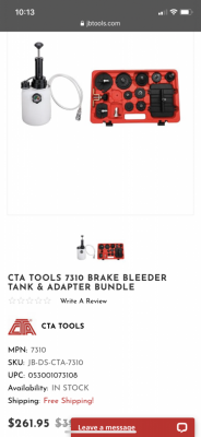

What is a better method / tool for bleeding?
I can imagine an air pocket getting inside the abs, or any where else, could turn frustrating, I always like better methods and better tools, Although if pressurizing a master this one is probably a couple grand or more, ya?
'16 Wagon Greene tune feed'n & fire'n 6.4L with 6spd 5.13 AAM, 37" KM3, -12mm Fuels Thuren Overland, DOR, Purple Cranium CAI, ARH, Solo Mach44 z36, EBC Custom vinyl AVS, 4% tint Morimoto, Rigid, Diode Dynamics AlfaOBD, Diablo, Nanny Kill, Locker bypass .................
this is the bleeder I use. Pressurizes the system then you bleed all around it holds fluid in it so it adds as needed

Props Dude, this is rokn. Single person too, that's icing. I watched a tuber show a single person method, I clustered it, felt like I would have been guessing if the air was purged even had I done it well. I just had to wait 6 hours for someone to be around for 5 minutes.
Never once through through the research was such a device even hinted towards, not an exhaustive search but plenty of different sources for info and protocol that it could have been mentioned, especially for $260.
Anyway, thank you!
Anyway, thank you!
It’s worth every penny to buy a bleeder kit like that. Especially with today’s abs systems. It’s that added confidence that no air is trapped and you’re not destroying the master cylinder pushing the brake pedal to the floor
