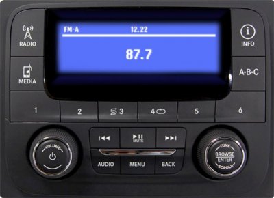

Are you 100% certain you still have an ra1 vs the radio being upgraded to an Ra2 by the previous owner? (Probably wouldn't have accepted the fw update though)
Sent from my SM-G930P using Tapatalk
E
EpicFish
Oct 1, 2016
Bump.
Pretty sure. It looks just like this:
