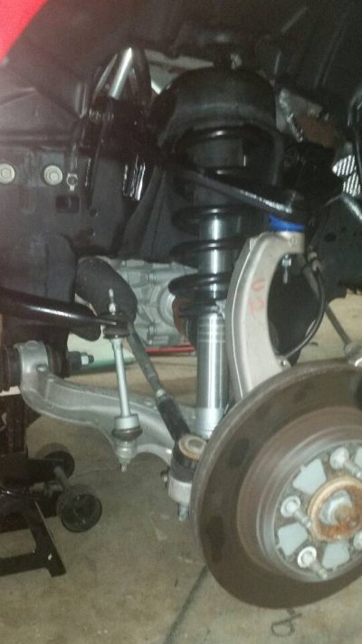

This is the photo I took before I started .Notice the amount of threads above the nut on the anti-sway bar.
Look close , steering arm is kinda in the way , but you can tell I did not even loosen the bottom , and i just loosened the top while still maintaining good thread engagement.
This pic is after I completed the install @ + 2.8 " , you can see I just tighten the top nut to where it was prior to starting the install .
Hope this helps
