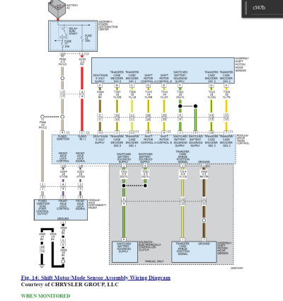

Your English is great, I could go to the store up the road and hear folks less proficient than you that are native speakers.
This site will let you know which wire is which by function...
Also, I've never had this problem myself but I guess it's a known issue and worth checking on your end...
This is to troubleshoot/identify...
This is to repair...

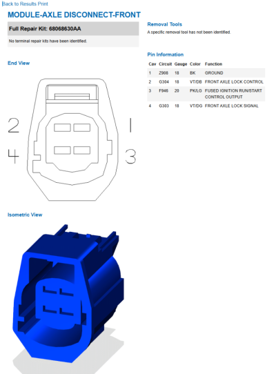

Hey, thanks a lot for your quick response. Looks like it's exactly what I need. I will check the pins of the front axle actuator.
I will also check the pins of the control unit plugs. I think the problem is there, because there are no LED's shining or flashing at the button unit (hope you know what I mean). And there is an error message "No communication with control unit AWD". This appears in 3 systens, engine control unit, ABS and TCM. Seems like AWD control unit has no power supply.

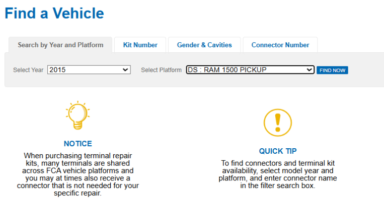

Could you help again to find out which components are the correct for the AWD control unit plugs in the document "https://connectorrepairkit.mopar.com/". I'm completely lost ...

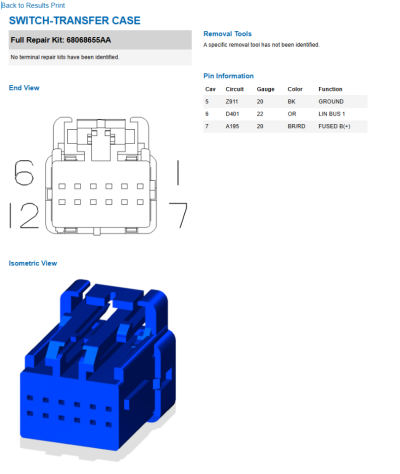

Sure, you'll want to search for:
This is for the connection at the switch in the cab of the truck which should be a green plug behind the radio/HVAC bezel (I don't think this will be the issue unless it's unplugged)...
and here is the connector under the truck shown in the videos...

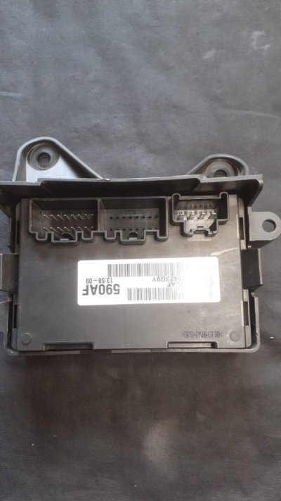

What I still need is the two connectors for the TCM control unit in the passenger footwell, see picture please.

I think I found it: MODULE-DRIVE TRAIN CONTROL C1 and C2
Do you agree?
That looks right but you can confirm by looking at the wire colors on the website and verifying them on the connectors. How to read them (example):
