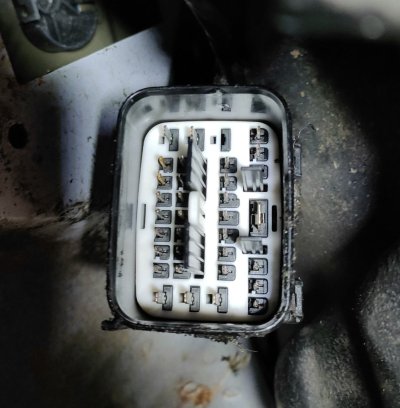

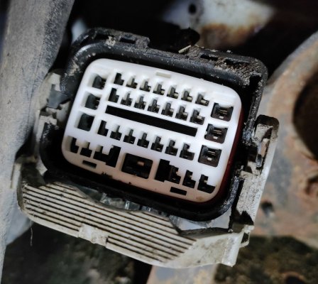

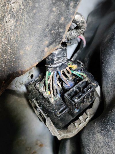

Hi everybody
My problem is with the big socket under the chassis at the driver's feet!
I no longer have a reversing camera or reversing lights and I have a big park sense alarm on the Miles screen.
I have one or more faulty rear bumper sensors but I never had this big alarm on my screen behind the wheel!
It all started with the gear change wheel which no longer worked, I then disconnected the battery and opened this big connector to clean it, it worked but I had several error codes, I opened it again, and now I only have three problems, but what to do? open it again? I really want to solder the wires and remove this connector !!! I hope the traduction is good
Sommes pictures of this socket
Sorry for my English

I have already done it, opened the socket, cleaned, inspected and applied KF F2 contact cleaner, I have errors which have disappeared but some have remained and I have the locking lever which no longer holds very well so I think that the socket no longer closes really well. I made an appointment at a garage to make the continuity in the socket and close it securely.
Jan 17, 2016
23,672
54,357
14 Sport
Creative use of some zipties will bypass the locking lever as far as holding the connector together
