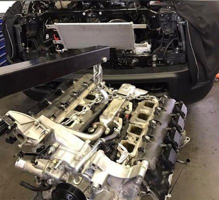

IMO, the bigger issue with a Whipple on our 6.4 is the factory EGR. The EGR cooler and most of the related components all need to be relocated, or deleted. For those with the dual alternator option, this runs off a secondary crank pulley so might present an issue as well. I would expect some other necessary changes around the intake, PCV and fueling need to be made on the 6.4. But would assume this is more of a minor effort on their part. The belt/accessory routing appears to be identical with the exception of a power steering pump on the 6.4.
Ram 6.4 EGR components
Dual alternator configuration
Ram 5.7 FEAD setup, similar to the 6.4
