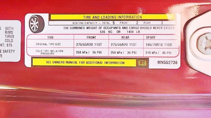

36PSI cold is the factory recommended setting.
Depends on which tire he has. Size isn't the only determining factor. The sticker in the driver side door jam lists the recommended tire pressures. That is always what I set mine to whenever I'm running factory tires. For aftermarket tires the chalk test that WY-Dave posted is a good way to determine optimal pressures to run.

I do 36 psi also because that’s what the owner manual says to do.
Actually, the owner's manual does not say what pressure to use. The manual covers all 2021 Ram 1500 models, and there are too many different tire sizes and types to list them all in the manual. It instead refers to the placard in the driver door jam that some of us have been talking about. Here's a capture from the owner's manual...

The door sticker in our new RAM says 36 psi for the 275/55R20 tires. I figure that is correct for everyday use.

I have not looked at my door sticker in a long time
You report that it reads 36 PSI, it should read 36 PSI in the early morning
