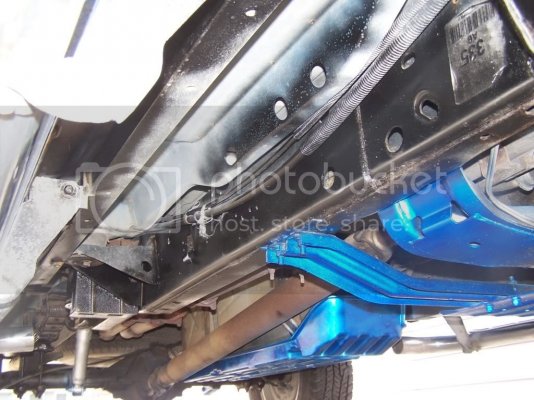

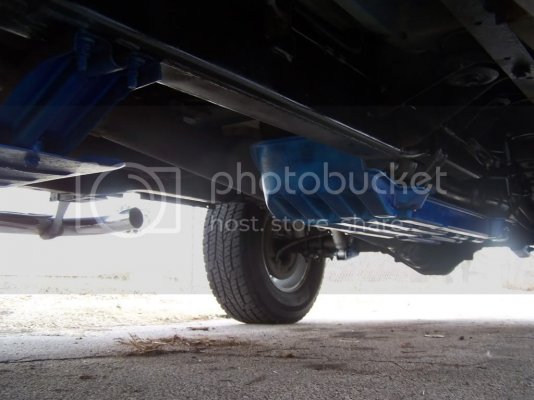

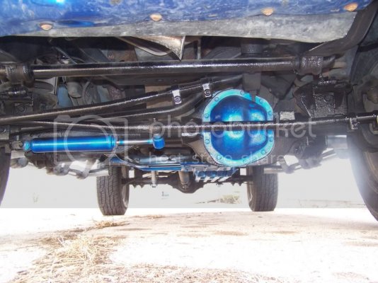

I sprayed mine have cleaning it with a lacquer paint. You can also use tractor enamel. The blue is Krylon X metal. I still need to go back under there again to spray some more.

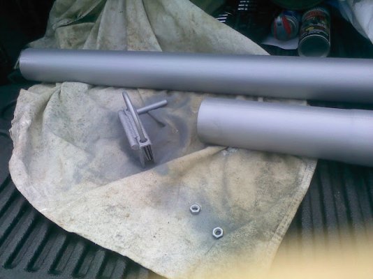

got some high heat paint an did this.Still waiting on the e-cut out. driveshaft is next.
