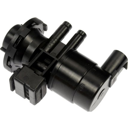

My Purge valve is under my fuse box.
There are 2 evap lines.
1- goes to throttle
2- goes to the back where the Leak Detector, Charcoal Canisters and Gas Tank are.
Which one goes where on the Purge Valve?
Thanks in advance!!

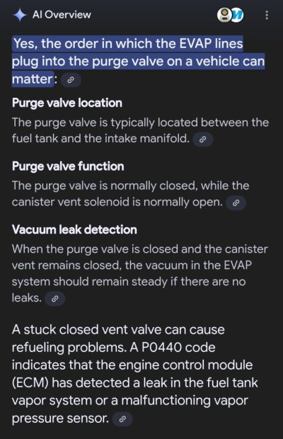

you see in the photo that one says VAC.
So that means it matters what line goes where, but I just don't know.
When i ask Google, this is what it gives me.

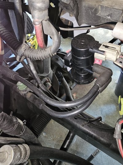

another thing to look for on the purge valve that is mounted by the battery & fuse box ..
Most of them have UP Arrow imprinted on the them, or the word TOP
I will ask Google for a 2002 Dodge Ram Purge Valve replace
video from TRQ
another video from a regular guy
both videos show that both hoses are connected together, they are not seperate

So, it really doesn't matter which one goes where then.
One of them have a service port connected to it.
This one is mine.
