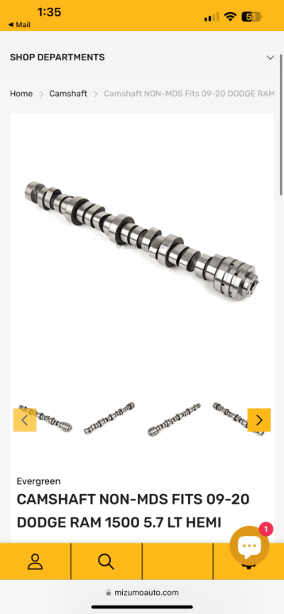

I’m trying to figure out if i need longer and or hardened pushrods. I bought some cheap lifters and they’re loud, so I decided to delete the MDS and I bought a stock non MDS Camshaft and some AMS racing V2 non MDs lifters.
I was wondering if I need longer pushrods and or I need to get hardened pushrods? Any one with experience

What does AMS say when you ask them about pushrods.They're the ones to ask first.
Good luck with those lifters,as they don't have a great rep,hopefully you got a good set.

Just buy a complete kit from Flyin' Ryan. Those lifters are garbage.
