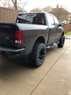

what he said...lol and yes the BDS instructions are a little "fuzzy" on this part of the install-I have 6" figured out the rake and went from there with my initial measurements, truck ended up perfectly level. (pic is on my drive which slopes down a bit-so front end looks high in the photo)
