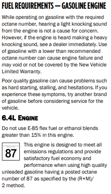

This is interesting as my 2021 just says to use 87 octane.
All they did was remove the part that said to use 89 for optimum performance and fuel economy, and changed the recommendation to 87. Directly above what you snipped it still says you might hear a light knocking sound. If you're ok with a light knocking sound and the ECU pulling timing that's your decision.
I run top tier premium 91-93. I paid for 405 HP, I want 405 HP.
Yep you are right. Strange why they would change the verbiage there. Was hoping I got away from needing higher quality fuel when I moved up to the 6.4.
6.4L was designed as a fleet work engine. It has lower compression is less aggressive in pursuit of top end power in the name of longevity and total cost of operation, as well as the lesser emissions requirements for HD trucks. Also beefed up cooling passages to keep cylinder temperatures more consistent.
It's designed from the ground up for 87.
There's an unwarranted assumption that there is absolutely no difference in mechanicals or timing spec's between the two years. There could be a difference that prompted a change in the owners' manual.

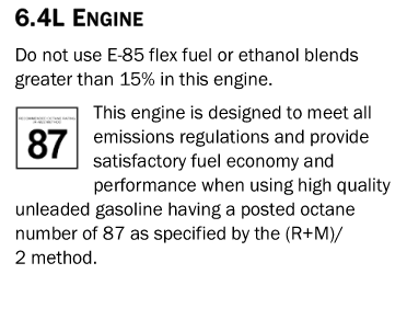

We were comparing 2020 6.4 to 2021 6.4, so in theory same engine. Why in 2020 was it 87 or 89 but 2021 says 87?

Note that early manuals did not distinguish between 5.7 and 6.4L, nor did the 2500 have a different manual than the 1500. The manual was simply for Ram trucks, lumping the 1500/2500/3500 together. 2019 is the first year the HDs get broken out into their own manual.
If we want to take the manual as gospel, it also recommends *against* anything higher than 89 in the earlier manuals:
5.7L/6.4L EnginesThis engine is designed to meet all emissions regulations and provide satisfactoryfuel economy and performance when using high quality unleaded gasoline havingan octane range of 87 to 89. The manufacturer recommends the use of 89 octane for optimumperformance. The use of premium gasoline (Over 89octane) is not recommended, as it will not provide anybenefit over regular gasoline in these engines.
Makes sense if the ECM can't adjust past 89 to not recommend it. Premium in a lot of places is no-ethanol so some guys see a big benefit/better mpg from it but thats not really because of the octane. Good info on the manuals only recently being separated out, your point of carry over language could definitely be applicable.
